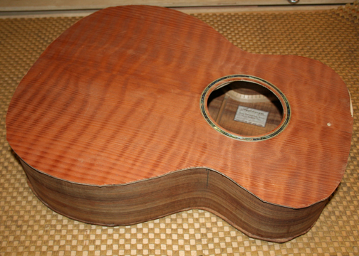

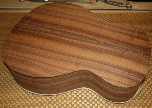

Hi guys,
here one of my latest guitars.
Curly Koa back and sides with a Semi-double Curly Redwood Top. Amazing tap tone from the box.....

Those are some pretty woods Peter.  What, for the newbie, is a semi-double top?

I too would like to know more about your semi-double top Peter.

Interesting choice of woods. Quite striking.
Dido on the semi-double top.

   That is some beautiful wood.....all the way around! I look forward to seeing
it progress into one of your typically gorgeous instruments.

I'll go into the my semi double top details tomorrow... too late!

Semi-double top construction is a simple method to strengthen figured soundboards that otherwise wouldn't be stable enough to use. All I do is trace the bracing pattern onto a spruce top that will be used as the backer for the top, then I remove wood from some of the areas surrounding the braces leaving only connecting areas to keep the integrity of the backer top. Then I glue both tops....VERY IMPORTANT....using a vacuum bag. If you don't have vacuum ability DO NOT do it as you won't be able to evenly distribute gluing pressure and may compromise the stability of the top.
